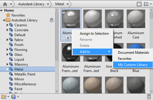

Add a Material to a Library
Click Render tab > System panel > Autodesk Rendering
On the Materials tab, right-click the material swatch > Add To > the name of the library where you want the material to be added. If no custom library exists, you need to create it first.
You can add the material to multiple libraries.
Tip: Alternative way to add materials to a library is to drag the swatch to the library.

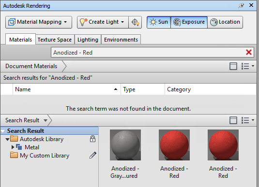

Search for a Material in the Library
In the search box at the top of the Materials tab, enter the name of the material.
The material library panel lists material libraries that contain matches for the search phrase you entered.
To clear the search and view the unfiltered library, click the X in the search box.
