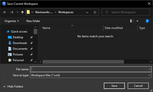

Save Current Layout to a New Workspace
Set up your design review layout. For example, you can group together the Properties and Saved Viewpoints windows.
Click View tab > Workspace panel > Save Workspace
.In the Save Current Workspace dialog box, enter a name for the new workspace. You can also select the name of an existing workspace to overwrite it with your modified configuration.
Click Save.
