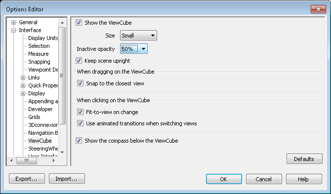

Control the Inactive Opacity of the ViewCube
  1. Right-click the ViewCube tool, and click ViewCube Options.
  2. In the Options Editor > Interface node > ViewCube page, select an option from the Inactive Opacity drop-down list.
  3. Click OK.
