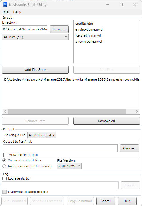

Generate a List of All Design Files Used in the Current Model
  1. In Navisworks, open the desired file and click Home tab > Tools panel > Batch Utility .
  2. In the Save Output As dialog box, browse to the desired folder, and enter the name for the text file.
  3. In the Save as Type drop-down list, select the File List (*.txt) option, and click Save.
  4. In the Navisworks Batch Utility dialog box, click the Run Command button.
    Tip: If you want to automatically open the file as soon as it’s been created, select the View File on Output check box before you click the Run Command button.
