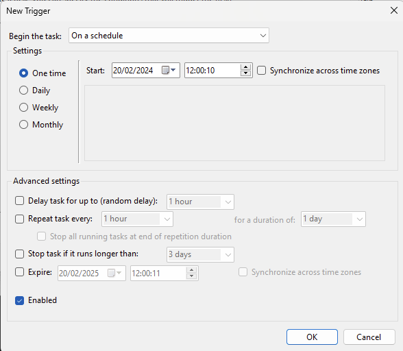

    In the Windows Task Scheduler, locate the Task Schedule Library folder, navigate to the newly created task, right-click and select properties. Click the Triggers tab, click new and schedule as required. You can add as many schedules as necessary.
  6. Click OK.
