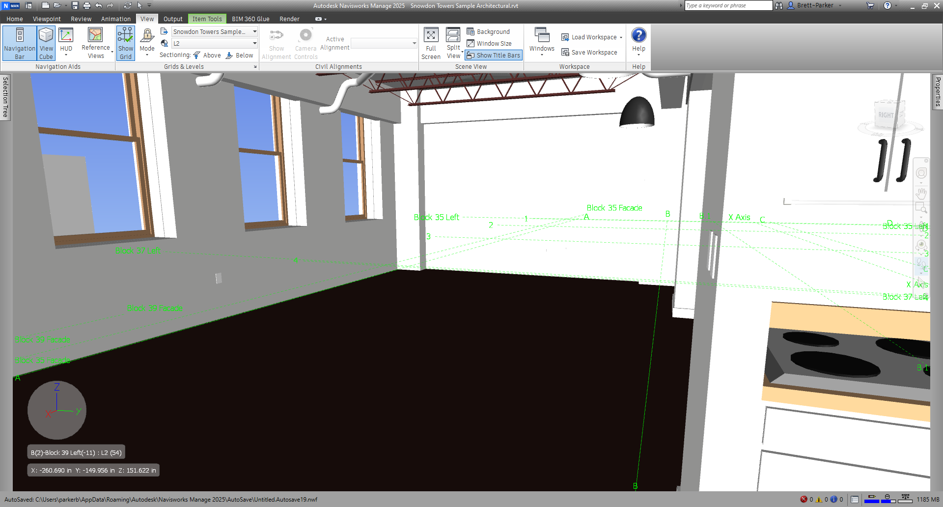

Grids and levels are displayed at each level of the building and are configured by default in relation to your camera position. For example, if you are standing on Level 2 of your building model, then the grid will be displayed in green on the floor below you, and displayed in red on the floor above you. You can change which levels of the grid are displayed, and in what colors, as required.
Grid locations are displayed on the Head-Up Display, showing the grid and level location of the camera relative to the active grid. The HUD display is based on the closest grid intersection to the current camera position, and the closest level below the current camera position.

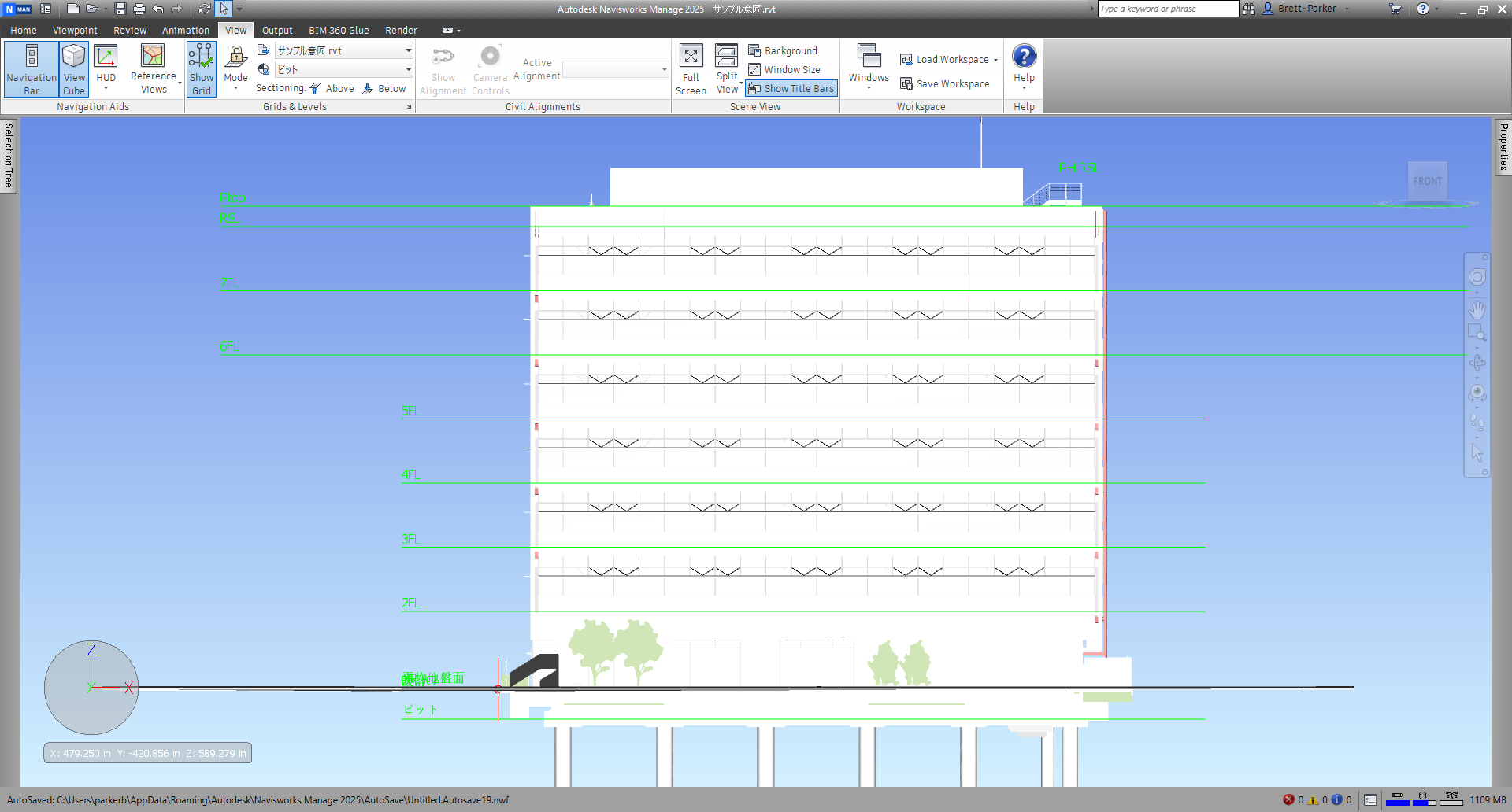

Grids and levels perspective camera projection
Grids and levels orthographic camera projection
