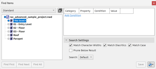

Find Items Window
The Find Items window is a dockable window that enables you to search for items having a common property or combination of properties.
The left pane contains the Find Selection Tree with a drop-down list at the top, and enables you to select the level of item to start searching at; this can be a file, a layer, an instance, a selection set, and so on.
The drop-down list options are the same as on the Selection Tree window:
Standard. Displays the default tree hierarchy, including all instancing.
Compact. Displays a simplified version of the tree hierarchy.
Properties. Displays the hierarchy based on the items’ properties.
Sets. Displays a list of selection and search sets. If no selection and search sets have been created, this option is not shown.
Note: The list of the items on the Sets option is exactly the same as the list on the Sets window.
The right pane enables you to add the search statements (or conditions). And the buttons enable you to find the qualifying items in your scene, and import and export your search parameters as XML files.
