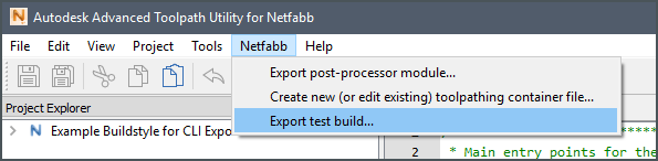

Exporting
Creating a test build will finally execute the whole build process.
