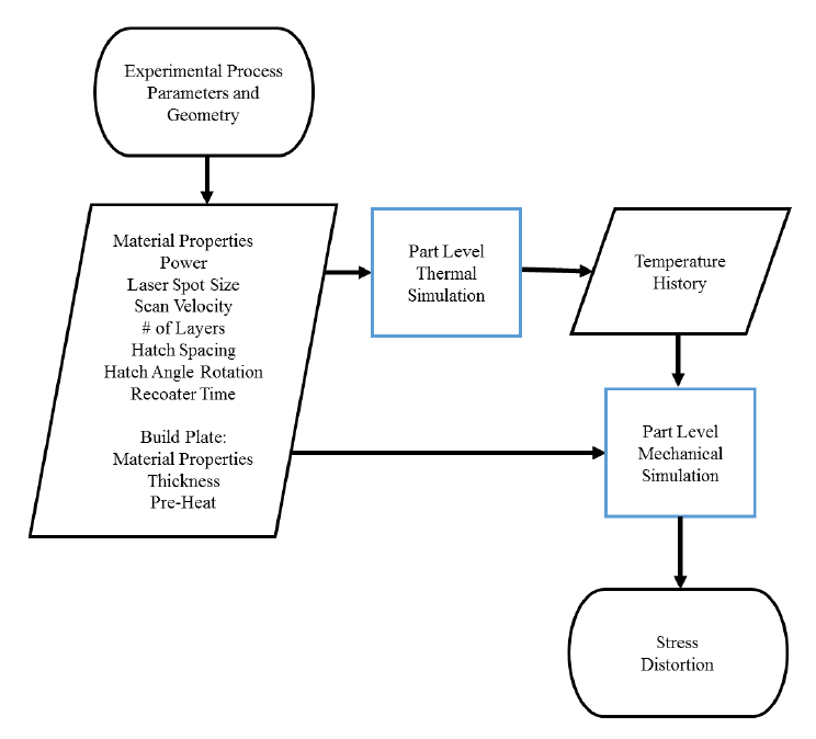

Workflow: The approach begins by submitting known process parameters into the Local Simulation thermal solver. The output thermal history is then input into the Netfabb Simulation mechanical solver.
Figure 4 illustrates the workflow.
Figure 4: Netfabb Simulation Powder-Bed Fine-Scale Model
