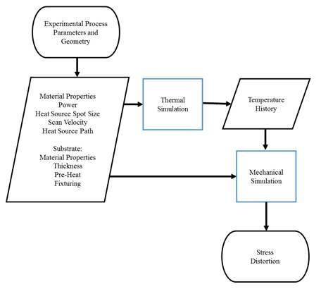

Workflow: The approach begins by submitting known process parameters into the Local Simulation thermal solver. The output thermal history is then input into the Netfabb Simulation mechanical solver.
Figure 5 illustrates the workflow.
Figure 5: Netfabb Simulation DED Model
