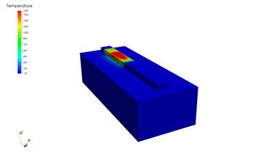

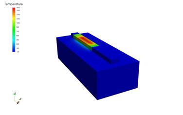

An illustration of the effect of using *LINQ is given in the following figure for the same simulation without using *LINQ (Figure a).
Required Cards: *GOLD, *TAUT, *LSRP or *LSRF.
(a)     *LINQ = off
(b)     *LINQ = 5
(c)     *LINQ = 10
