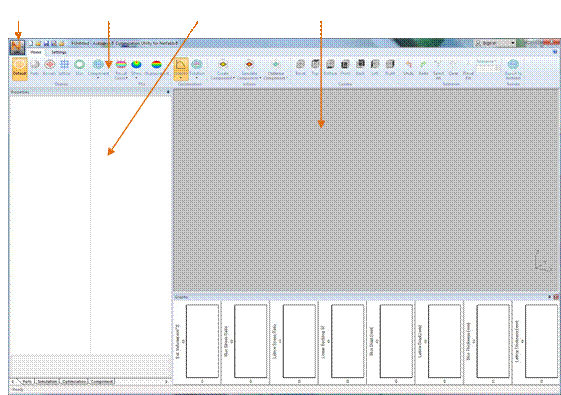

The Optimization Utility software interface is shown below consists of the following elements:
- File menu
- Toolbar
- Properties panel
- 3D Display
| File Menu | Toolbar | Properties Panel | 3D Display |
