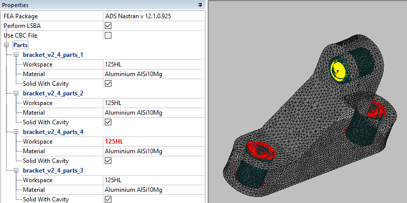

"T2214: MATERIAL PROPERTY ID 1 IS NOT UNIQUE" |
If you have multiple parts in the project, on the Simulation tab, make sure they all have the same workspace selected. ![]() |

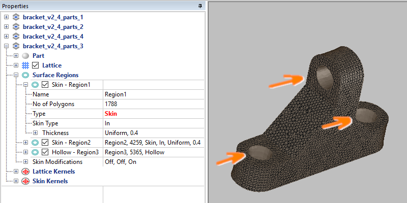

"FATAL ERROR E5001: NON-POSITIVE DEFINITE DETECTED AT GRID […]" |
If you have forces acting into a lattice, on the Parts tab, make sure that the interfacing surface is set to Skin, not Solid. Select Solid only for parts that are actually fully solid. ![]() |
