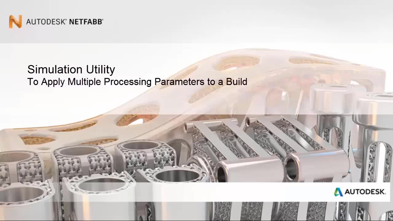

Tutorial 14: To Apply Multiple Parameter Sets
Explore the options for applying different PRM files to parts and supports.
Video length (1:56).
