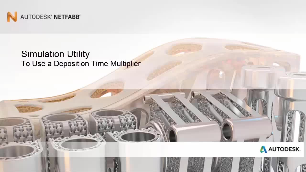

Tutorial 6: To Use a Deposition Time Multiplier
Simulate the building of multiple parts on the same build plate.
This video discusses the concept of a deposition multiplier and how it can be used to get a faster solution for your analysis.
Video length (3:28).
