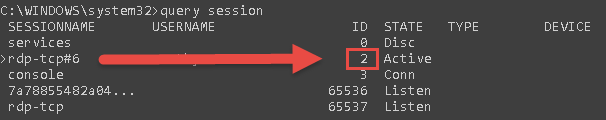

    Determine your remote desktop session ID
    1. At the Command prompt, type query session and press Enter.
    2. Find the ID number in the rdp-tcp row (typically 1 or 2).
