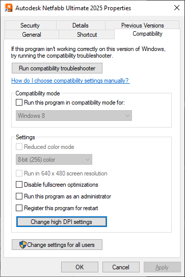

Display scaling
"My display text is too large!"
"Window elements are missing or obstructed by the task bar!"
You may have Netfabb configured to determine the font size automatically while you have Microsoft® Windows® configured to scale text beyond 100 % which can confuse Netfabb's font scaling.
Solution:

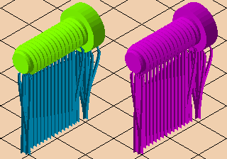

Exporting parts with support
"When exporting a part with support to STL, the STL file does not contain support!"
Unless configured otherwise, Netfabb treats support meshes differently than normal part meshes. STL does not make this distinction. That is why any supports that are not regular meshes are dropped when exporting to STL.
Left: Dedicated support mesh ("support attachment") is displayed in light blue. Right: Regular-mesh supports show up in the part's (or assembly's) display color or its own actual color (not shown).
To export a part including its supports to STL, you must convert any support attachment mesh (blue) to regular part mesh, and then export all parts into the same STL.
  • To convert existing support attachment mesh to a separate mesh, select the supported part, then choose Prepare > Manage supports > Split support to new part
  • To always create supports as separate mesh immediately by default, switch System > Settings > Supports > Export as part attachment to No.
  • To export multiple parts into one STL file, select both parts in the project tree, then choose File > Export part > as STL and make sure in the next dialog that Output type is set to All into one file.
