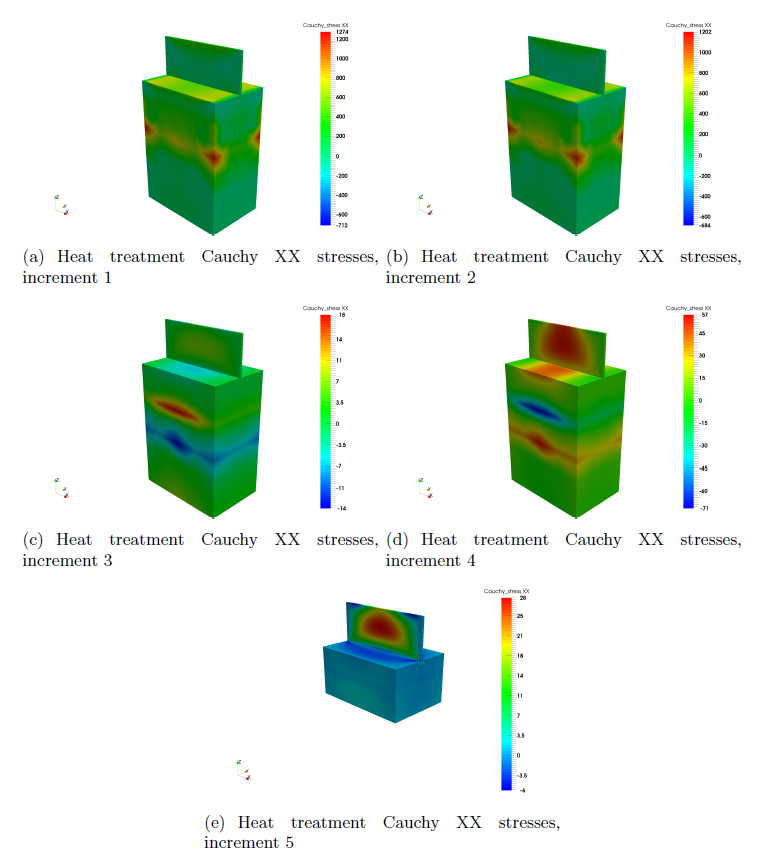

Figure 4 shows the modeled stresses at different increments during the heat treatment simulation.
Figure 4: Heat treatment Cauchy XX stress results

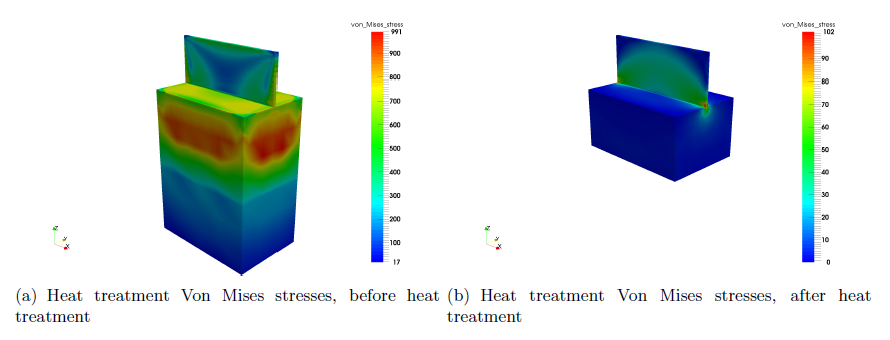

Observe the stresses reduce as the temperatures increase. Then as the heated part is slowly brought back to room temperature, new thermal stresses are introduced. Looking at the Von Mises stresses in Figure 5, the final, room temperature part has peak stresses that are 90% of the peak stresses prior to heat treatment. This achieves the goal of removing 90% of the stresses induced by the LPBF construction process by the means of stress relief heat treatment.
Figure 5: Von Mises stress results before and after heat treatment
