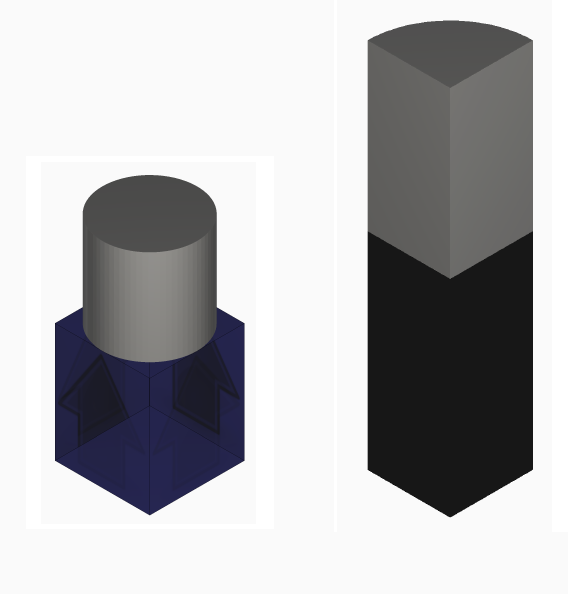

In this example, symmetry boundary conditions are applied to the thermo-mechanical simulation of a cobalt chrome cylinder. Figure 1 shows the original and quarter-symmetric model.
Symmetry boundary conditions are applied to the X and Y faces at the origin using the *SYMM card.
Figure 1: Original and segmented cylinder geometries
