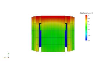

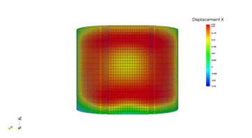

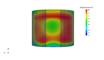

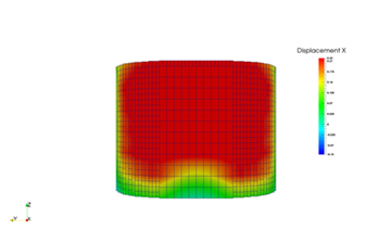

One can see in the first figure below that using *PBPA values that are too high will not preserve the geometry of the reference .stl file. As the *PBPA values are decreased (subsequent figures) geometry is preserved, but the mesh may be too coarse to resolve the solution accurately. As *PBPA moves towards the limiting value of 5, the solution converges. However, reducing *PBPA comes at the cost of increasing run times. Looking at the converged solution for the *PBPA = 10 and 5, the single core run time increases by 6 times.
*PBPA=125, Thermo-mechanical run time = 3.12 s
*PBPA=25, Thermo-mechanical run time = 43.9 s
*PBPA=10, Thermo-mechanical run time = 43.9 s
*PBPA = 5
