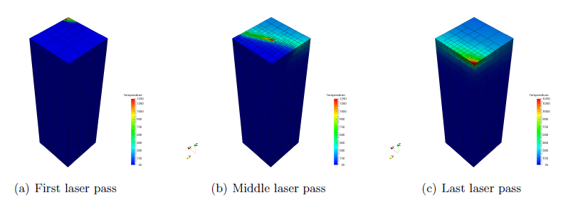

Results can be imported and viewed in Simulation Utility for Netfabb or ParaView. The results at three different time steps: beginning, middle, and end of the simulation, are shown in Figure 1.
Figure 1: Temperature select time increments
