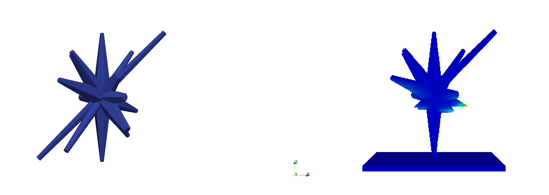

Disconnected elements
In the figure on the left, you see a complex part. On the right is the solved simulation. Unsupported elements radiating downward have been removed because they could not be built from the bottom up. Rotating the build volume or adding support structures can eliminate these warnings.
