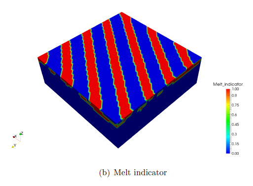

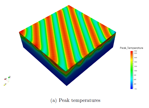

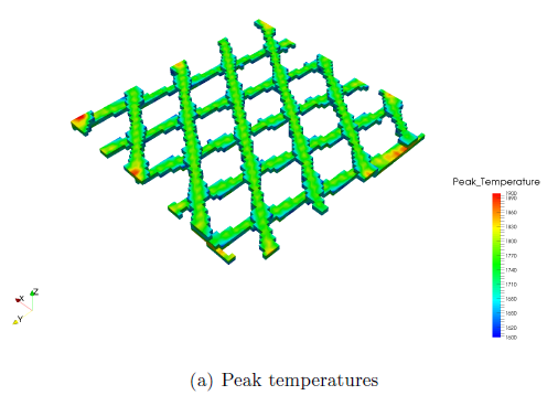

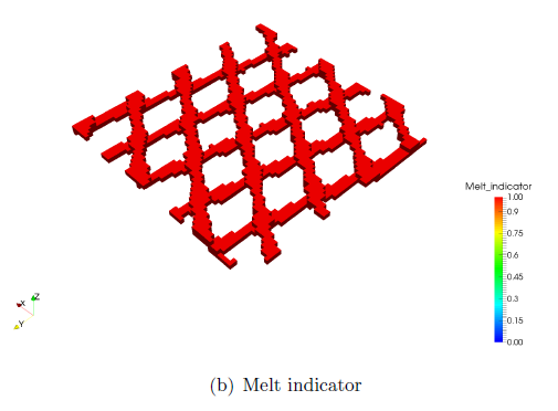

Figure 1 shows the results of the two state variables added to the ParaView results when using *LFUS in the moving adaptivity simulation.
Figure 1: *LFUS results moving adaptive mesh, (a) Peak temperatures
(b) Melt indicator

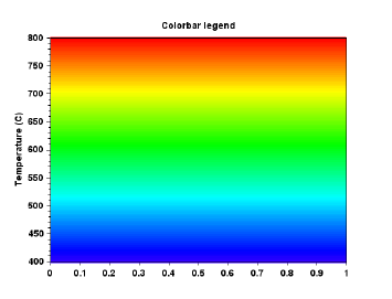

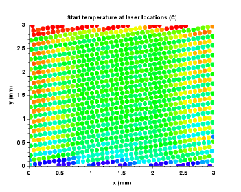

These preheating results can also be visualized using the visual tool of the user’s choice (e.g. Scilab, Matlab, Python). An example for a similar simulation using a 3 mm × 3 mm block is presented in Figure 2.
Figure 2: Visualization of *TPRE results, (a) Colorbar
(b) *TPRE Contour

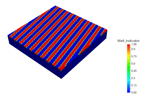

Figure 4 shows the peak temperature and melt indicator results for elements that have a melt indicator value of 1.
Figure 4: LFUS results multilayer mesh using threshold filtering

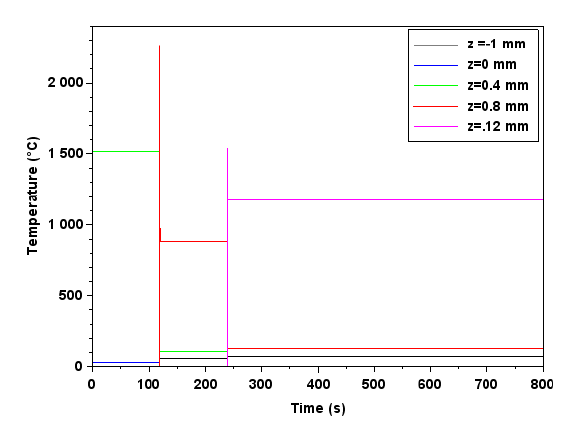

Using timex for multilayer adaptivity simulations
From the command line run
$ timex timex-madap-input.txt
This is similar to the timex input file shown in Example 1, but with the additional cards *CRSE and *SHFT which enable timex to work with multilayer adaptivity. The above example timex input file records the temperatures at the center of the build cross section x=0.25 mm, y=0.25 at 6 different z locations. Running the above command will produce the file timex_peaktemp_t10multilayer.txt. A plot of the temperatures at 6 queried locations is shown in Figure 5.
Figure 5: Multilayer adaptivity thermal history of the build region center at 6 z locations
