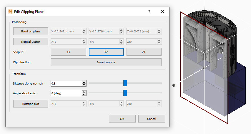

The Edit Clipping Plane dialog provides several methods to adjust the plane location and orientation:
- Snap to a pair of axes through the center of the part, XY, YZ, or ZX
- Change the clip direction to see the opposite side of the part by clicking Invert normal.
- In the Transform area, use the slider for Distance along normal to move the plane through the part; use the slider for Angle about axis to tilt the plane.
- In the Positioning area, click Point on plane or Normal vector and adjust the numeric X, Y, and Z settings for the object.
When the clipping plane is in the correct location, click
OK to close the dialog, while still displaying the cross section and editing tools. If you want to edit the plane again, click
Edit
