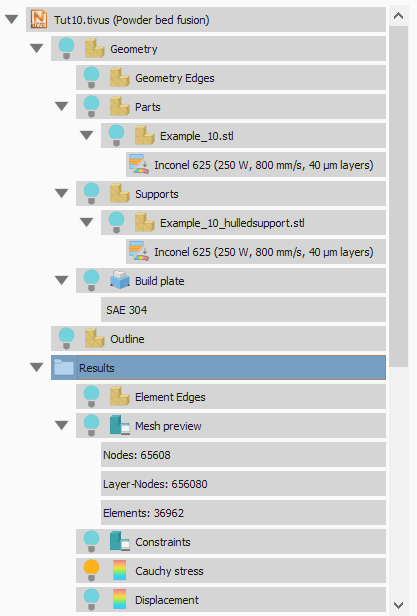

Control the display of parts and simulation results by clicking light bulb icons in the Browser, on the left side of the Local Simulation window.
Before running a simulation, you can check the Browser to verify the material and PRM file assigned to the part, and the material for the build plate, if different from the part. After solving a simulation, the Results appear in the Browser. The figure below is only a partial display of Results. Click off the light bulbs (
) to turn off the Geometry, Build plate or Outline display, and turn on (
) one of the Results, such as Displacement or Cauchy stress.
For any of the Geometry or Results items, you can right-click for access to Render Properties and other options. Parts and support structures have the following options on the right-click menu:

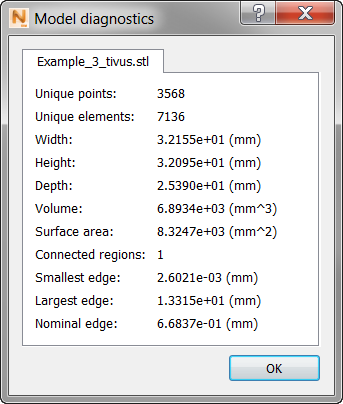

- Diagnostics displays a range of physical data about the model, as in this example:

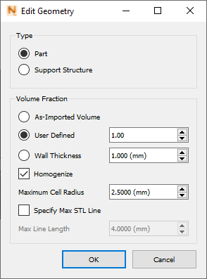

- Edit Geometry opens the Edit Geometry dialog, where you can change the geometry to a Part or Support Structure, and for a Support Structure, you can change the Volume Fraction. Refer to
Homogenization of Support Structures for instructions on how to determine the volume fraction of a support structure.
