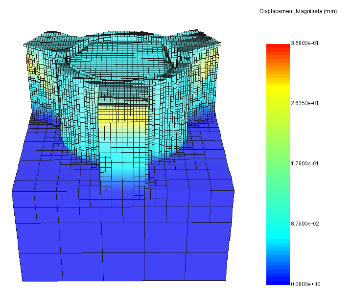

Figure 3 displays the displacement results of the thermo-mechanical simulation at the end of the build process, after part cool-down. The part has been warped by displacement with no additional magnification. The support structure to the fore of the picture is the Solid support, assigned a volume fraction of 0.22, to the left is the Loose zero-thickness support, with a calculated volume fraction of 0.11, and to the right the Fine zero thickness support, with the largest volume fraction, calculated to be 0.178. The Solid and Fine supports exhibit an equivalent trend and value of distortion, while the Loose lattice-type support shows roughly 25% more distortion than the other supports.
Figure 3: STL homogenization example displacement results

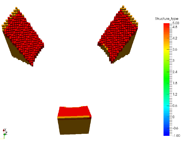

Figure 4 gives the structure type results at the end of the simulation, which is most useful in this case for investigating support structure failures. The figure has been filtered to show only the support structure and failed support structure types. This shows that these disparate support types all exhibit similar levels of failure.
Figure 4: STL homogenization example support failure results
