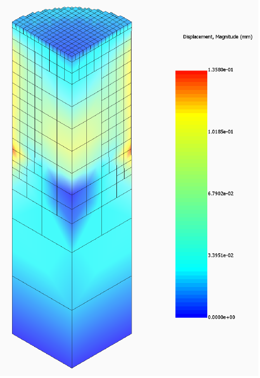

Results can be imported and viewed in ParaView or the Simulation Utility for Netfabb. Figure 2 shows the computed final distortion after substrate release. Observe the 0 displacement at the origin, showing the effect of the symmetry conditions.
Figure 2: Final distortion
