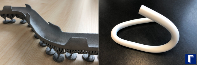

Various different methods of additive manufacturing use supports to help keep a part's distortion due to thermal effects to a minimum, allow the deposition of overhanging shapes, and provide general fixation and rigidity during the process. With suitable configuration, supports could even be incorporated into the part's design where they perform as mounting points, for example.
On this pipe forming tool with bar support bouquets and bottom plates, the supports remain on the part. (Part and image: Gramm UG)

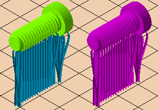

Parametric supports vs. support meshes
By default, Netfabb handles the supports it generates parametrically: While they are in fact meshes, they are marked, handled, and displayed as attachments and retain how they were generated so that they can be modified instead of having to effectively reverse-engineer and regenerate them from scratch.
This enables a more flexible work with supports:
  • They can be regenerated with fewer or no manual steps whenever an arrangement or orientation changes.
  • Attachments are exempt from some integrity checking. This way they can have holes and lack volumes, something that would be regarded as faults for any regular part mesh, and still be accepted and processed properly by the toolpath generator during slicing.
To help distinguish parts from supports, Netfabb handles parametric supports as attachments colored in blue by default.
Important: The distinction between part and support is saved in the FABBPROJECT file, but during export into parts, this is usually dropped.
Currently, only the 3MF format knows the difference, although Netfabb writes only the generated mesh to it, not the procedures used to generate them. When saved to STL, for example, parametric supports are dropped completely, leaving only the part in the export.
Left: Dedicated support mesh attachment is displayed in light blue. Right: Regular-mesh supports show up in the part's display color or its own actual color (not shown).
You can change this behavior by switching Settings > Settings > Supports > Apply as part attachment to No, but bear in mind that this can have unexpected or even undesirable effects.
  • It can affect part placement on platforms of machine workspaces, particularly those that have an option to enforce a distance between parts and platform.
  • Toolpathing may treat support mesh as regular part mesh, but since it tends to be technically faulty mesh (ie. have open contours rather than closed volumes), toolpathing may either not run at all or produce possibly unwanted results.
  • Fault checking treats it as a regular part, likely finding problems that wouldn't matter for dedicated support toolpathing, and needlessly warning about them.
