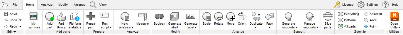

- Main menu: The main menu at the top of
Netfabb's window holds most of the functions. When appropriate, it changes the contents to provide you with the functions that you need for what you are currently doing.
The Home tab collates the items used most often during preparation.
You can also create your own tab in the main menu with the commands you need.

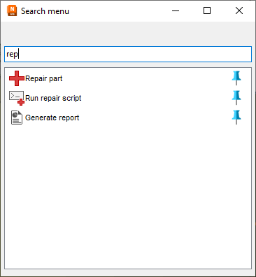

- Command search: Most commands sorted into the various main menu categories are accessible through a common search function: Open the search dialog (), begin typing the name of the command, or a word likely to be contained in the command's name, and the search narrows down the possible matches as you type. Then select the command so found to execute it right there, or
pin it to the dialog so that it always appears even when you have not searched for it yet.
Find the right command with just a few keystrokes.
