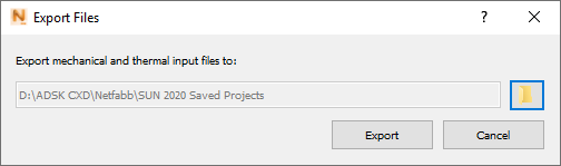

- Export solver input files, including thermal and mechanical input files (if available) to support running a new simulation

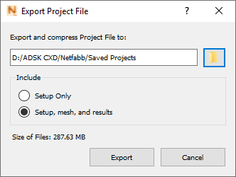

- Export project files, with two further choices:
- Setup only, including geometry, PRM file, TIVUS file, and input files for running a new simulation
- Setup, mesh, and results, which include the complete project, so that running a new simulation is not required

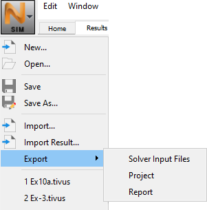

- On the Simulation menu, select Export, and then either Solver Input Files, Project, or Report.
- If you selected Solver Input Files, check the proposed export path, and if you want to change it, click the folder button on the right.
- If you selected Project, choose whether to include only the Setup files, or Setup, mesh, and results.
The size of the file package before compression is shown in the dialog. Note the proposed path to the saved file package, and if you want to change it, click the folder button on the right.
