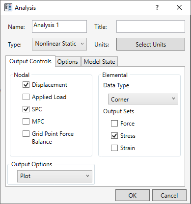

- Right-click on Analysis 1 and select Edit.
- Change Type to Nonlinear Static
- On the
Options tab, ensure that
On is selected for
Large Displacements.
- Click
OK.
