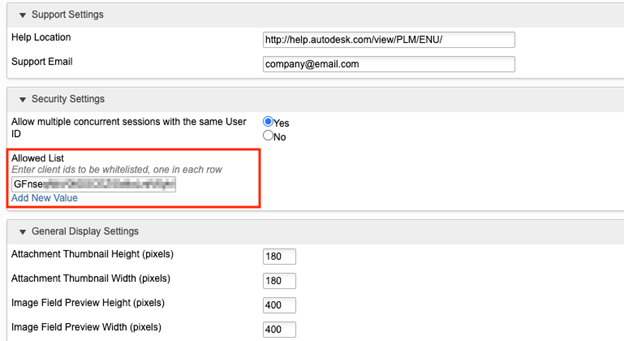

  4. Add the application to the Allowed List in Fusion Manage (Administration > General Settings > Security Settings).
    This enables all tokens generated for that application to be used when authenticating into Fusion Manage.

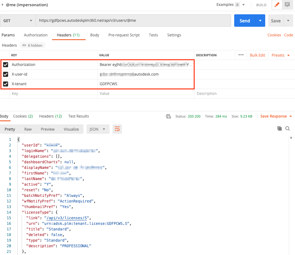

When performing a request, add:
  • The Authentication token, in the format “Bearer BEARER_TOKEN”
  • The X-user-id value as an e-mail (a valid, active user address in the system)
    • This user is going to be impersonated in all calls using the token above.
    • In most integrations, this is a “service” user, with proper permissions to accomplish the workflows in the integration.
    • All calls in the system are done as if being performed by this user; in other words, permissions, validation, workspaces, and more. They are all tied to the user specified here.
  • The “Accept” header value, if applicable, depending on the endpoint being called
cURL Example
curl -X GET -H "Authorization: Bearer [your access token]" -H " "X-user-id: [user e-mail]" -H "Accept: application/json" -H "Content-Type: application/json" " https://[tenant name].autodeskplm360.net/api/v3/workspaces?unlimited=true
