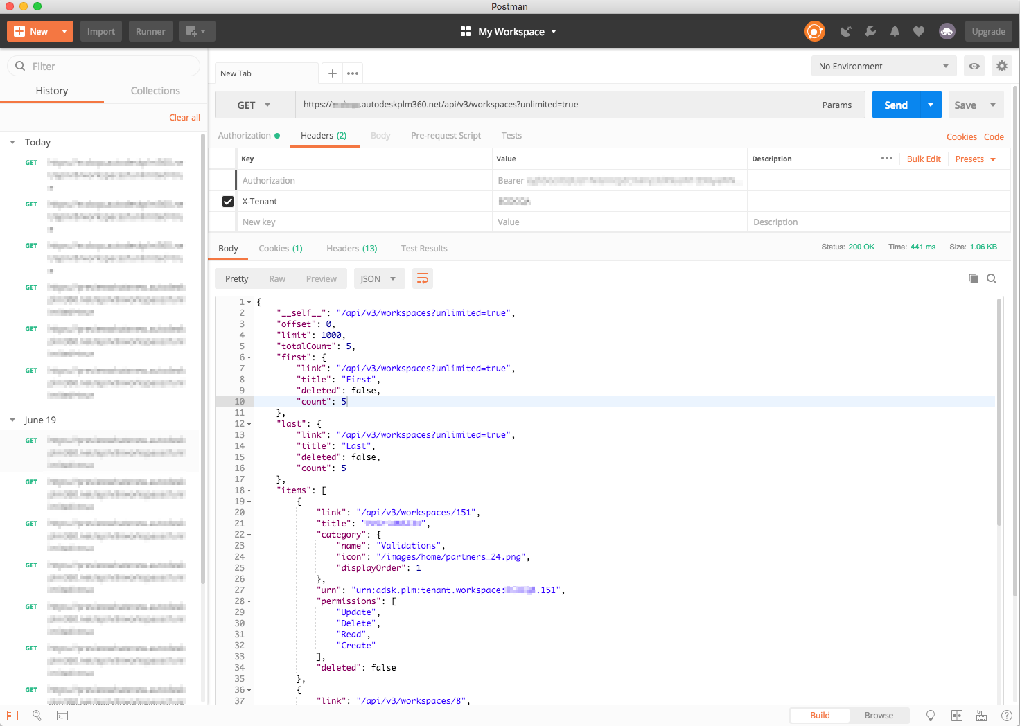

When performing a request, add:
  • the Authentication token, in the format “Bearer BEARER_TOKEN”
  • the “Accept” header value, if applicable
cURL Example
curl -X GET -H "Authorization: Bearer [your access token]" -H "x-tenant: [your tenant name]" -H "Accept: application/json" -H "Content-Type: application/json" " https://[tenant name].autodeskplm360.net/api/v3/workspaces?unlimited=true
