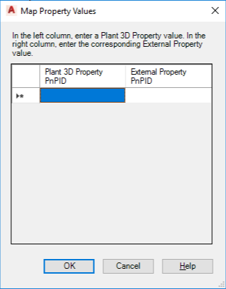

Map Property Values Dialog Box
Defines matching property values between AutoCAD Plant 3D toolset and other programs.
Mapping property values allows you to set corresponding property values between AutoCAD Plant 3D toolset and another program.
Plant 3D Property - <Name>
Enter P&ID property values that need to correspond with similar properties in another program.
External Property - <Name>
Enter values corresponding to properties referenced by the program you plan to export to or import from.
