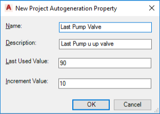

New Project Autogeneration Property Dialog Box (Select Project Autogeneration Property Dialog Box)
Creates a new project-based property to automatically generate a value.
Name
Unique name used to reference the property. The name cannot contain spaces; use an underscore to separate words.
Description
Description used to explain what the property is used for.
Last Used Value
Value used as the previous value of the property.
Increment Value
Value at which the property should increment to create the next value.
