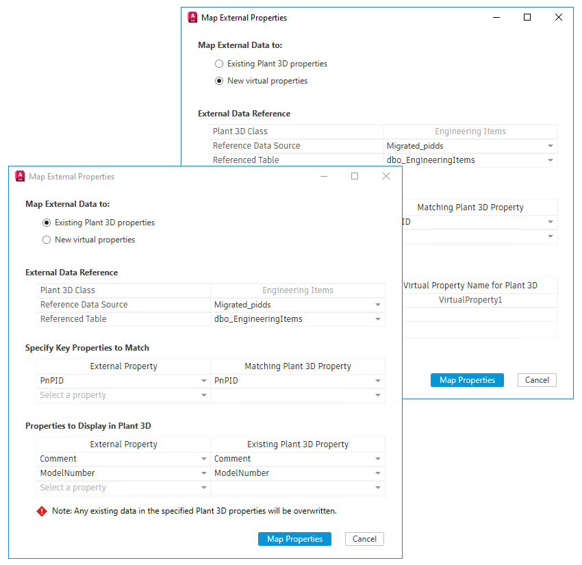

About Mapping Properties from External Data Sources
Share plant object data with external data sources by mapping properties in Project Setup. You can add an external data source from either a database setup or from the Map External Properties dialog box in Project Setup.
Note: The virtual property is listed as "Mapped" type.
After you specify the different mapping properties, click Map Properties to either add a virtual property or map to an existing Plant 3D property in Project Setup.
