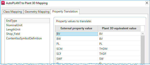

On the Property Translation tab, you make sure that values specific to AutoPLANT properties are correctly interpreted during the conversion.
For example, the AutoPLANT endtype property value BW maps to (translates to) BV in the language of Plant 3D.
You can add additional properties with specific value translations as needed. The translations affect all classes in a project.
