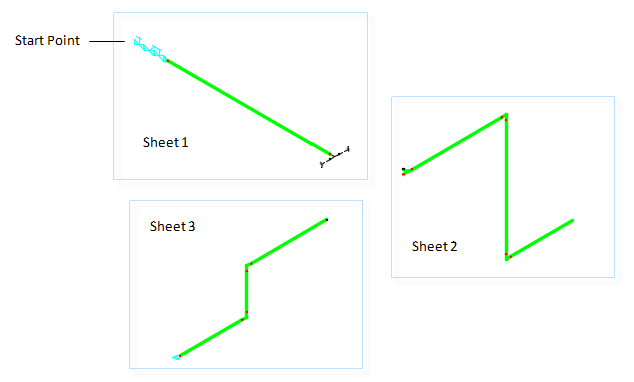

After creating isometric drawings, you can save sheet split points into the 3D model as break points. The next time you create isometric drawings the same split points are used.

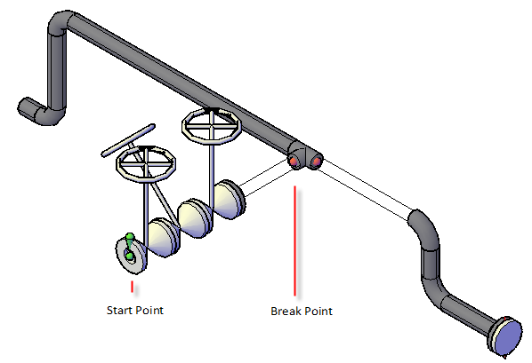

The start point specifies where the line begins on sheet 1. Break points split isometric drawings into sheets.
The isometric start point and split points can be explicitly placed into the 3D model. The next time an isometric drawings are created the same split points are used.
