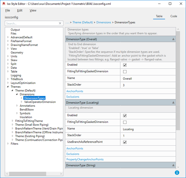

Use the Iso Style Editor for advanced isometric customization in the IsoConfig.xml file.
The Iso Style Editor displays the corresponding IsoConfig.xml for advanced isometric customization. In the Project Setup dialog box, iso Settings page, click .
The left pane in the Iso Style Editor displays the same structure as in the IsoConfig.xml. Expand each node to display its sub-nodes.
You can switch view to display the settings in a table or code view.
