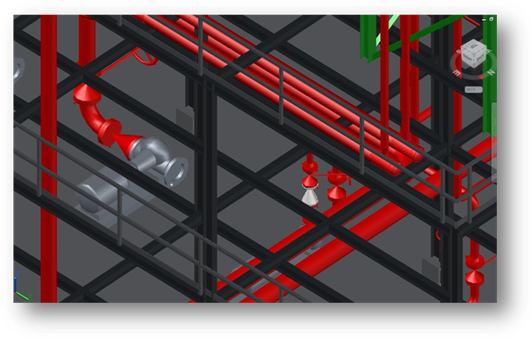

Modeling Using Xrefs
Xref's make it very easy to work in large models. Here the piping designer is concentrating on piping around a pump:

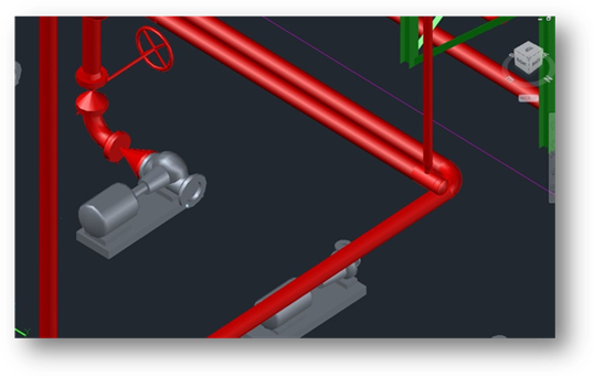

By unloading the structure and turning off some of the piping layers, a better view is obtained making piping easier:
