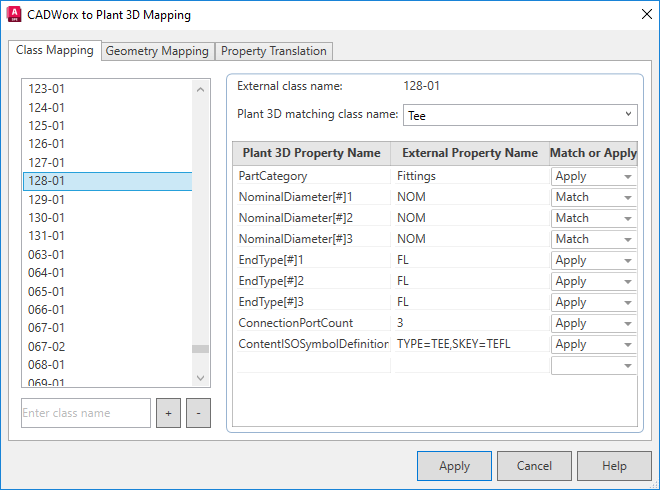

Class Mapping (CADWorx to Plant 3D Mapping Dialog Box)
Maps global and individual class CADWorx properties to Plant 3D equivalents.

Global Class Properties List
Note: The first five items in the list on the left pane are global class properties.
Lists global properties that apply to all classes. Once these properties are mapped, you do not need to map them again for individual classes.
External Class Names List
Note: The remaining items in the list on the left pane are external class names.
Lists CADWorx classes (represented by numbers) that can map to a Plant 3D class.
Plus (+) Button
Adds a new CADWorx class name to the External Class Names list. Enter text into the box and click the + button to add a class name.
Note: To reuse existing mappings, right-click an existing class to copy the mapping information, then right-click the new class to paste the information. This action affects only this tab.
Minus (-) Button
Deletes an CADWorx class name from the External Class Names list.
External Class Name
Displays the CADWorx class name selected from the External Class Names list on the left pane.
Plant 3D Matching Class Name
Specifies the Plant 3D class that corresponds to the CADWorx class selected on the left pane. When you select one of the global mappings, this field is read-only.
Plant 3D Property Name
Specifies the Plant 3D properties that you want mapped to the CADWorx properties for the class selected on the left pane.
External Property Name
Specifies the CADWorx properties for the class selected on the left pane.
Match or Apply
Specifies whether you want to match the properties or apply a specific property value. For example, for the CADWorx 128-01 class, the Plant 3D NominalDiameter property matches CADWorx NOM. But the Plant 3D PartCategory property is set to the specific value Fittings.
