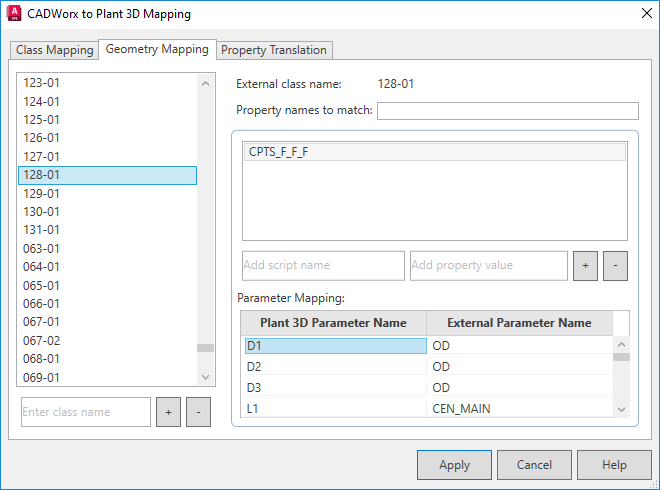

Geometry Mapping (CADWorx to Plant 3D Mapping Dialog Box)
Selects graphic scripts and maps dimensional properties or parameters.
List of Options
External Class Names List
Lists CADWorx class names that can map to a Plant 3D class.
Plus (+) Button
Adds a new CADWorx class name to the External Class Names list. Enter text into the box and click the + button to add a class name.
Note: To reuse an existing script, right-click an existing class to copy the mapping information, then right-click the new class to paste the information. This action affects only this tab.
Minus (-) Button
Deletes an CADWorx class name from the External Class Names list.
External Class Name
Displays the CADWorx class name selected from the External Class Names list on the left pane.
Property Names to Match
Specifies CADWorx property names to match to Plant 3D graphic scripts in varying contexts.
Separate multiple property names with commas.
Add Script Name
Adds a Plant 3D endtype graphics script name to the list.
  • Plus (+) button. Adds a new row that includes the entered script name and property value.
  • Minus (-) button. Deletes a selected row that includes the entered script name and property value.
Add Property Value
Adds property values for the CADWorx property.
Parameter Mapping
Specifies parameter mapping between Plant 3D and CADWorx. Each geometry mapping has a corresponding set of parameters, which can vary depending on the shape.
The image that follows shows a Plant 3D threaded female tee in the Catalog tab.
The Plant 3D dimension parameters for the shape are listed, and you can enter them in the Parameter Mapping table in the Plant 3D Parameter Name column. You can then enter the corresponding CADWorx property name (or value).
  • Plant 3D Parameter Name. Specifies the Plant 3D graphic script dimension parameter to map to the CADWorx parameter.
  • External Parameter Name or Value. Specifies the CADWorx parameter name, expression, or value to map to the Plant 3D parameter.
