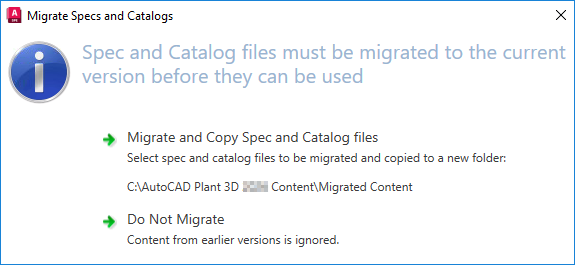

  1. Click Tools menuMigrate Specs and Catalogs.
  2. Click Migrate and Copy Spec and Catalog Files.
  3. In the Select Specs and Catalogs to Migrate dialog box, specify one or more files (for example, C:\AutoCAD Plant 3D 20xx Content\CPak ASME\ASME Valves Catalog.pcat).
  4. In the Spec and Catalog Migration Complete dialog, click Open the Migrated Files Folder in File Explorer to view the migrated content.
