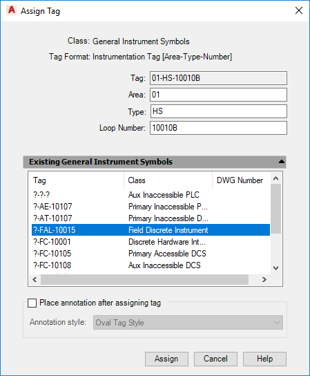

    If your administrator has set up tag formatting, the Assign Tag dialog box displays when you add a component or line that requires a tag.
    You add components and lines to a drawing or model from a ribbon or tool palette. If you do not know the tagging data at the time you insert a component or line, you can add the data to a 3D model later by clicking Home tab Part Insertion panel Assign Tag and clicking the component or line.
