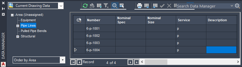

  1. On the ribbon, click Home tab > Project panel > Data Manager.
  2. In the Data Manager, in the drop-down list, click Current Drawing Data.
  3. In the Order By list, click Order by Area.
  4. In the tree view, expand Area. Click Pipe Lines.

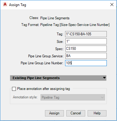

  5. In the data view, double-click in the Tag column of the line number that you want to change.
  6. In the Assign Tag dialog box, in the box labeled Number, enter the line number (for example: 105).
  7. Click Assign.
