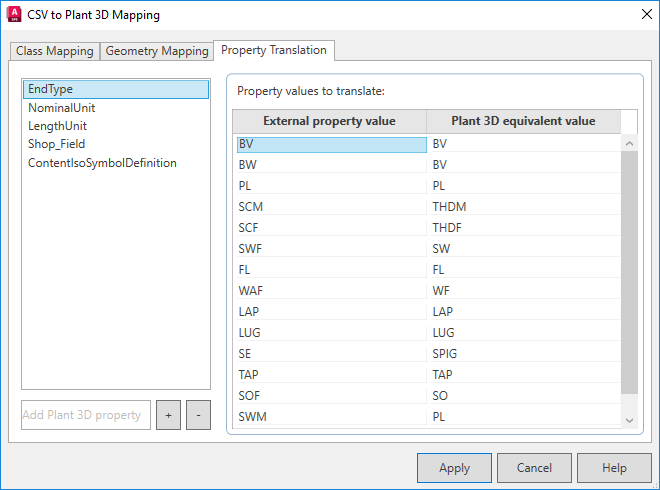

Property Translation (CSV to Plant 3D Mapping Dialog Box)
Translates CSV property values into Plant 3D equivalents.
The translations affect all classes in a project.
Note: AutoPLANT mappings display by default. If you use another third-party program, delete these mappings and create new ones for your specific program.
List of Options
Properties List
Lists added Plant 3D properties that receive values from the 3rd-party spec and require translation.
Plus (+) Button
Adds a new Plant 3D property. Enter text into the box and click the + button to add a property.
Note: To reuse an existing script, right-click an existing property to copy the mapping information, then right-click the new property to paste the information. This action affects only this tab.
Minus (-) Button
Deletes the selected 3D property from the list.
Property Values to Translate
Displays a two-column table with 3rd-party properties on the left and Plant 3D equivalents on the right.
  • External Property Value. Displays the 3rd-party value for the property selected from the list on the left pane.
  • Plant 3D Equivalent Value. Specifies the Plant 3D equivalent value for the property selected from the list on the left pane.
