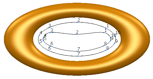

The closed curve morphing method, with In Projection deselected, works best for surfaces that lie entirely outside or on the reference curve.

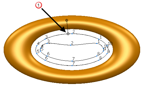

  1. For each point on the selected curve, the closest point on the reference curve is identified .

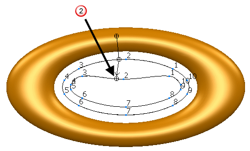

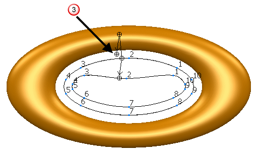

  2. A distance and direction is defined from the point on the reference curve to the point with the same number on the control curve .
  3. The point on the surfaces to be morphed is moved by this distance and direction, reduced by any decay that you may have defined .

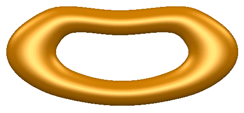

  4. Click on OK to produce the result below.
