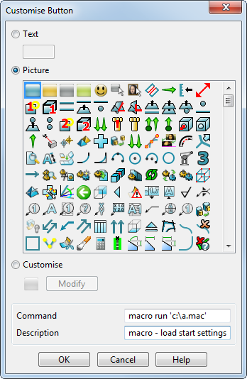

Customize Button dialog
Use this dialog to:
  • enter text to display as the item's button.
  • select a picture to be displayed as the item's button.
  • select a picture to edit or customize using the bitmap editing functionality on the Customize Picture dialog.
  • change the description of a command. This option is displayed only if you have selected Command from the Type list.
Text — Select this option and enter text to be displayed as a button.
Picture — Select this option and select an icon to be displayed as a button.
Customize — Select the option to enable the Modify button. Click the Modify button to edit the selected picture in the Customize Picture dialog before adding it to a toolbar.
Command — Edit the command.
Description — Edit the description of the command.
