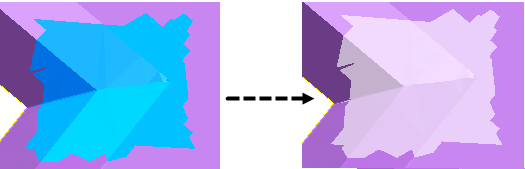

    To mask selected triangles on a mesh:
    1. Select a mesh.
    2. Click Mesh Tools tab > Selection panel > Mask.
      The selected triangles are masked.
      Masked triangles are hidden and drawn as transparent. They are not used in subsequent operations until they are unmasked:
