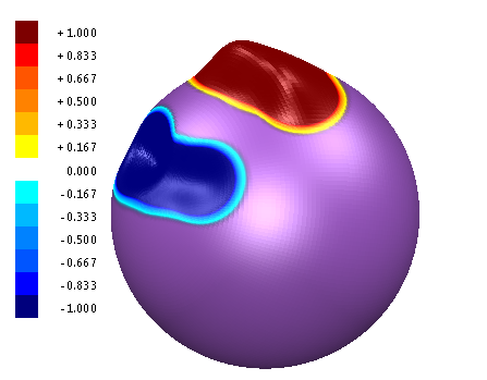

Use Show Deviations to see the difference between the original and sculpted models when using the editing tools.
  1. Select a mesh.
  2. Click Mesh Tools tab > Triangles panel > Sculpt to display the Sculpting toolbar.
  3. Select the Add Material option and move the mouse to add material to the mesh:
  4. Select the Show Deviations option to see the difference between the original and the sculpted model. The analysis scale enables you to see the percentage of material that you have added to the model:
    Alternatively, select Show Deviations before adding the material to see the dynamic changes.
